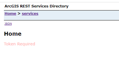

for the fsURL in the init.json file I have the URL of the Hosted Feature Layer.
Is this the correct URL for the fsURL?
When I copy and paste that URL into my web browser it goes to an ARCGIS REST service directory but it says Token Required

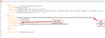

Yes, that is the correct URL to put in there, but, the HFS will also have at least one layer in it.  This script monitors for changes in a layer in the HFS, so you need to supply the layer number for the fsLayerNum: in the json file.  Here is my file with sensitive info changed:
I use internal mail server, with no issues (set in the "email" portion of the json file "server": ).

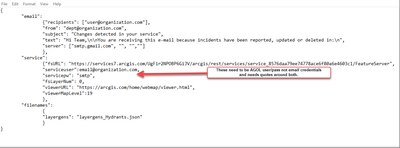

I made a copy of the init.json file for you to look at and edited out the sensitive information.
I left the fsLayerNum value set to 0 because that is what it shows in the service URL when I view it.
Here is the init.json file
RhettZufelt
MVP Notable Contributor
Are you using your internal smtp server and just changed to gmail as that is sensitive?  I ask, as there are specific instructions in the original post of how to configure if using gmail.
Other than that, I see you have serviceuser and servicepw in the init.json set to an email, and smtp.
This needs to be the AGOL username and password that has access to the service (otherwise, token errors).
Also, the serviceuser does not have quotes around it, which causes it to throw the exact error of you earlier post (why it is not parsing the json correctly).

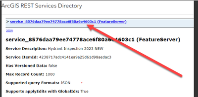

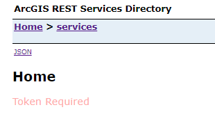

I think I am missing something from the fsURL.
When I copy and paste that URL into a web browser, it goes to this page

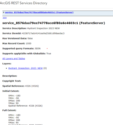

but when I click on view from the HFS overview page, it goes to the FS REST Service Directory
RhettZufelt
After your second example, right click on the >service_...... at the top and open in new window/tab.

Should I copy that URL for the fsURL in the init.json file?
SLouq
by MVP Alum
MVP Alum
It adds a tokenID to the URL
