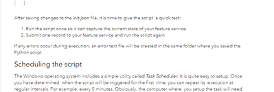

If you follow the directions linked above, Step 1 of the script part is to  download the script:
That zip file has the python script AND the init.json file.  The init.json file is what needs to be modified with the blue items from the link above, the included script is what you run in python3.
Then:
RhettZufelt_1-1681930733165.pngYou need to run the script once at firsts, this will create the layergens_ms.json file, which captures the 'state' of the HFL at that time.

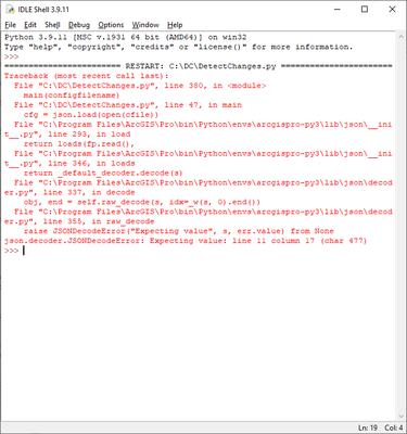

I ran the python script in IDLE and it outputs this file.
I was getting the error I specified in a reply yesterday of Unable to generate token but then got it to output this file. Does this look correct?
My IT guy is telling me this needs to be run on the database server.

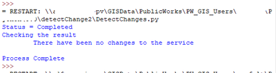

The first time you run it, should look like this:

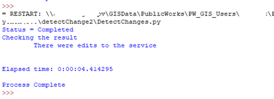

Then, if you make any change to the data and run again:
and get an email like:
If running as a scheduled task, you don't see IDLE, so will just get the email when something chaged.

It looks like you are having an issue reading the json config file.  Is your init.json file in the same directory as the DetectChanges.py file?
Is it sensitive, or can you share the text content of your init.json file to help troubleshoot? (Can direct message me if you like)
