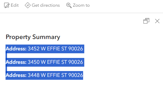

So I am trying to pull attributes from an intersected layer in a single popup. In certain popups however, there are for example 3 layers that overlay one another in the same location. Basically 3 address points thus 3 addresses as shown in the screenshot below.
Now is there a way I can have the Address: string to appear only once?
Also is it possible to adding numbering to the addresses (if more than 1 address is present) as shown in the desired output?
@KenBuja please when you have the time, can you have a look at it? Thank you 🙂
Current output (please ignore the blue color that's just due to the mouse selection):

Here's one way to do that. Unfortunately, the Arcade element strips out leading spaces, so everything gets left justified.
var Address = FeatureSetByName($map, "ADDRESS");
var intersectLayer = Intersects(Address, $feature);
var popup = '<h3>Property Summary</h3><b>Addresses:</b>';
var counter = 1;
for (var f in intersectLayer){
  popup += `${counter}) ${f.FullAddress}<br>`;
  counter++;

Wait, I was incorrect about stripping leading spaces. The only way I was able to add leading spaces is using "&nbsp" for each space
popup += `&nbsp&nbsp&nbsp&nbsp&nbsp&nbsp${counter}) ${f.FullAddress}<br>`;
