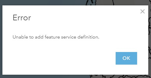

I'm having an issue in AGOL when creating a Joined Hosted Feature Layer View in which I get the following message:
"Unable to add feature service definition."

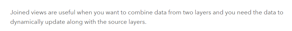

This seems to fit the intended remit in Esri documentation:
Using this joined data, updated survey information can dynamically appear on a dashboard that references this data. For the intended display / filtering implemented in the dashboard, the polygon data is the recipient of the I : M :Joined Features.

**** Update : 2023/07/09 : I have tested this further and the error with the join view only appears to occur if the survey contains a repeat in the Survey123 Connect design. Without the repeat in the survey, it appears to join successfully, so is not a Survey123 Connect issue, as much as it appears to be a repeat issue.
DeanMoiler_MapAction
Just as an update, this has now been logged as a BUG by Esri Support:
BUG-000160077: Not able to create a Joined view layer in ArcGIS Online with layers that have related tables.

ChristopherCounsell
MVP Frequent Contributor
Survey123 is used to create the Hosted Feature Layer. Outside of that, you are looking at a join between two Hosted Feature Layers. A repeat creates a 'related table'. It's a non-spatial, table sublayer in your Hosted Feature Layer created by Survey123.
In the past, users have had issues with Joins for a variety of reasons e.g.
support.esri.com/en-us/bug/join-feature-fails-with-a-feature-layer-from-survey123-bug-000117882
or
https://community.esri.com/t5/arcgis-online-questions/join-feature-analysis-error-unable-to-add-feat...
Where they had reserved words in the Survey123.
If you can share your XLSForm and the steps you are following to do the join, with configuration, it may help.

I have a similar situation, although when I try to create the joined view layer between a poly layer and a survey child table, I get "The view layer could not be created." Do you think that is a different issue, since the error message is different?
If you have a repeat in your survey data, it's likely the same. I've just recreated this issue and I also seem to get this error when trying with my data:
