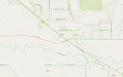

Hi @Teresa_Blader , from what I can find I don't think this is possible with an out-of-the-box solution.
However, I wondered if the Esri layer 'Transportation' would be useful for you? It's available via here: https://services2.arcgis.com/FiaPA4ga0iQKduv3/arcgis/rest/services/Transportation_v1/FeatureServer

Teresa_Blader
Thanks for the reply. While we don't manage our bus transit lines, we do manage our own streets, so Esri's database is out of date in comparison to our centerlines, and also doesn't include transit lines 🙁
