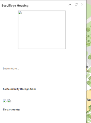

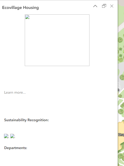

Hello! I am trying to create a popup that displays an image from the URL in the Picture field of my feature layer. However, some features do not have a picture URL and are null and in those cases I would like it to display nothing, instead of the broken image icon or the outline of where the image should be.
I have been messing around with different Arcade expressions and HTML tags but cannot seem to figure it out.
Is there any way to do this?
