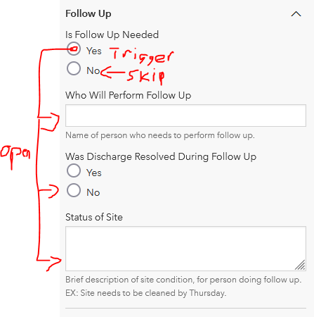

I have created a layer for collecting illicit discharge points for our storm water infrastructure.  In field maps application I created a form with a number of questions that have arcade expression conditions to them.  Such as does the inspection need follow up: yes/no if the answer is yes a series of further questions open up.   It works great in field maps.  But I do not see this same conditional question tree working in map viewer (we are using new one not classic).  This is causing issues because some of these conditional questions are marked as required only if they are opened but otherwise they aren't needed.  But in map viewer this is messing up submitting points due to things being required that are not needed.  For now I have taken off requirements and am encouraging people to work off field maps instead of map viewer.   It is very frustrating to take the time to build these forms and them not work across to map viewer.

I have the exact same problem. I created a form a month ago with some questions that are conditionnal to another field value. But since the new update this week (march 2022), these conditions aren't working on Map Viewer, so we can see ALL fields while we should see just some of them. It's really frustrating as it's really not usefull to see all of them.
Conditionnal visibily works for groups but not for fields. Not sure why.
