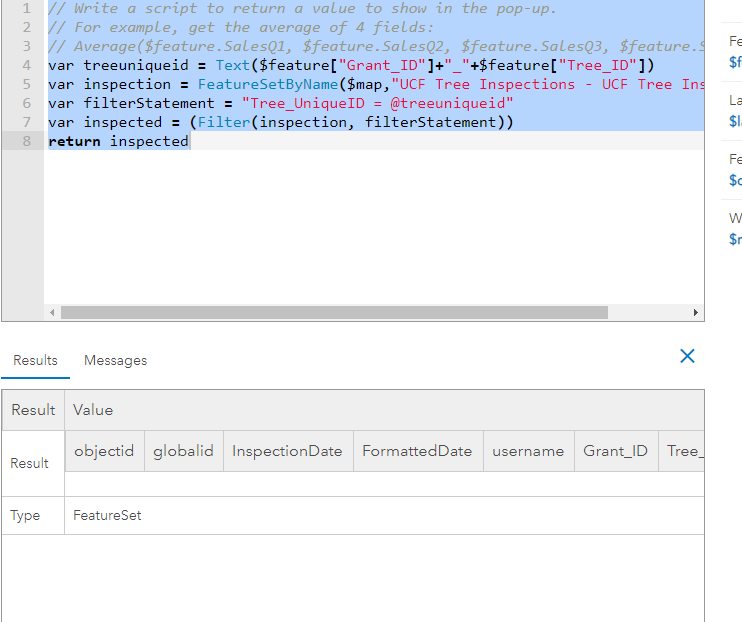

Line 1 of my expression creates a unique id from two fields in layer A:
var treeuniqueid = Text($feature["Grant_ID"]+"_"+$feature["Tree_ID"])
Line 2 of my expression uses FeatureSetByName to access the attributes from layer B:
var inspection = FeatureSetByName($map,"UCF Tree Inspections - UCF Tree Inspections")
Line 3 adds in a filterStatement to match the records in layers A & B:
var filterStatement = "Tree_UniqueID = @treeuniqueid"
Lines 4&5 use Filter to only return the information for the selected tree point in the web map.
var inspected = Filter(inspection, filterStatement)
return inspected

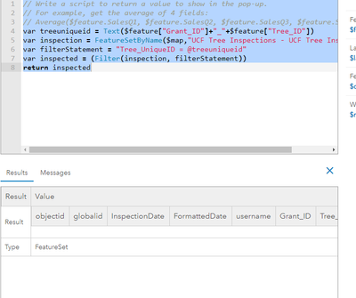

In the expression window the results show that I am accessing layer B attributes:
but I get this in the pop-up itself:
Is using the created variable treeuniqueid to essentially 'join' the tables from the two layers an issue?

The problem, in this case, is that you are returning a featureset to the pop-up. That is something the pop-up can't visualize. It does show in the expression builder, but this does not mean that it will show in the pop-up. You will probably have to loop through the features in the featureset and construct the text that you want to return.
Have a look at https://community.esri.com/t5/arcgis-online-documents/using-featuresetby-functions-in-arcade-to-dril... and the second code block where a list of maintenances of a hydrant is formatted and returned to the pop-up.

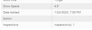

Sorry for the delay, but I was stuck in some meetings. I just had a look at the data and I think I have the answer. As you can see it now returns the  number of inspections:
There was just a tiny mistake in the expression. when you construct the SQL you use an underscore "_" when the data uses a hyphen "-". Also in my case the name of the layer was a bit different, but this could just be for me.
