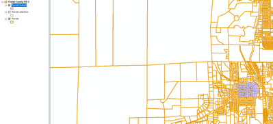

When I import the data to my ArcGIS (Using ArcMap 10.4), the file is quite large so I have been attempting to select specific areas in the parcel layer (e.g 500 parcels, all adjacent)
I select the all the parcels I want to review and it highlights them as usual.  (however extremely slow compared to other parcel searches from different counties)
I then do the Data-Export Data -and save the shapefile.
When I open up this new layer nothing shows up and the Attributes Table only shows headers.

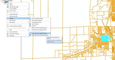

  1. Select the subset of the parcel data
  2. Right click on the layer in the table of contents and go to 'Selection' > 'Create Layer from Selected Features'

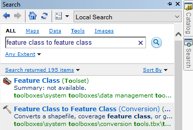

  3. In the search pane, search for 'Feature Class to Feature Class' N_W_S_E_0-1653399907765.png
    Select Feature Class to Feature Class (conversion)

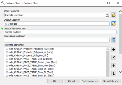

  4. Fill in the parameters in the Feature Class to Feature Class conversion dialogue boxN_W_S_E_2-1653400293969.png

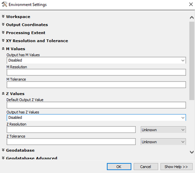

  5. Click 'Environments...' and disable M and Z values N_W_S_E_3-1653400374847.png
  6. Click 'ok', and then run the feature class to feature class conversion

It could be that the dataset has Z and M values associated with it. After your selection, and when you're in the Data > Export Data dialogue box, select the Environments button at the bottom. When in the Environments, disable Z and M values, and then try to export.
Note: this is just off of pure speculation; I have not looked into the dataset. If this method doesn't work, let me know and I will download the dataset and explore it myself to offer other solutions.
