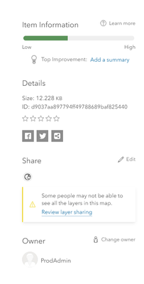

Good to hear you sorted out the problematic layer even if it took some sleuthing to track it down. I just wanted to note there is an easy way to check if any sharing issues for layers in a web map. On the item page as the map owner (or administrator), you'll see a notice if a map has any layers that aren't shared at the same level as the map. It will show under the share section on the right hand side of the map's item page if any access issues are detected.
The review layer sharing link will open a dialog that lists any layers with access issues (along with the ability to update sharing if allowed):
It is only able to detect sharing issues for hosted layers and other layer items. It doesn't detect service issues that lead to access issues (like enterprise services that aren't accessible to the public or other service-level issues, etc) but should work well for catching any basic sharing issues especially when you have a map with lots of layers and need to track down a layer that has been unshared out from under the map.
