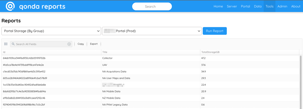

Joe you could look at something like Qonda Reports which captures all storage info and allows you to report on this by group.

Very slick. I'll keep that in mind if I ever get to the point I can justify the budget.
Anyone else have a more cost-effective solution specifically for Group content? I basically had to make a list of all the feature services in a group and cross reference them in the stock Storage report from AGOL.
