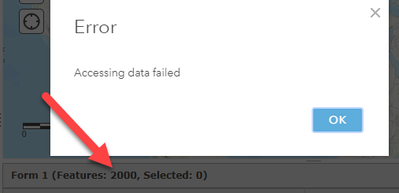

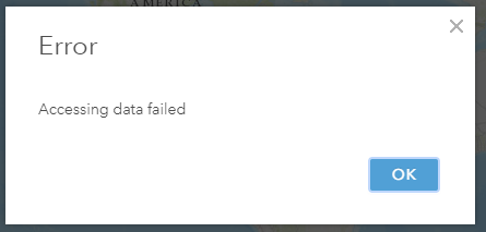

Whenever I publish a new Survey123 Connect form, I am getting the same "accessing data failed" error message when trying to open the feature in AGOL Map Viewer. At first I thought it was my survey or questions/answers at hand. But even when I publish a generic form from "advanced template" with the example questions without submitting any survey responses, I am getting the same error message. I am using Survey123 Connect, version 3.14.261

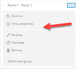

Even when I create a new form as a blank template with the sample questions provided and no records are submitted to the form, I get the same error when trying to open up the attribute table in map viewer classic and no "show table" option is visible in map viewer.

Thanks for the link Amanda! We tried submitting a form through the Survey123 app (which opens up fine, and the desktop form version works well as well!), and the same error comes up. We can see the data from the Data tab but we cannot create maps with the service feature layer due to this error.
One particular thing we noticed is that even though there are no records submitted through the form, when we try to open up the attribute table it shows there are 2,000 features through the greyed out screen of where the table should be.
