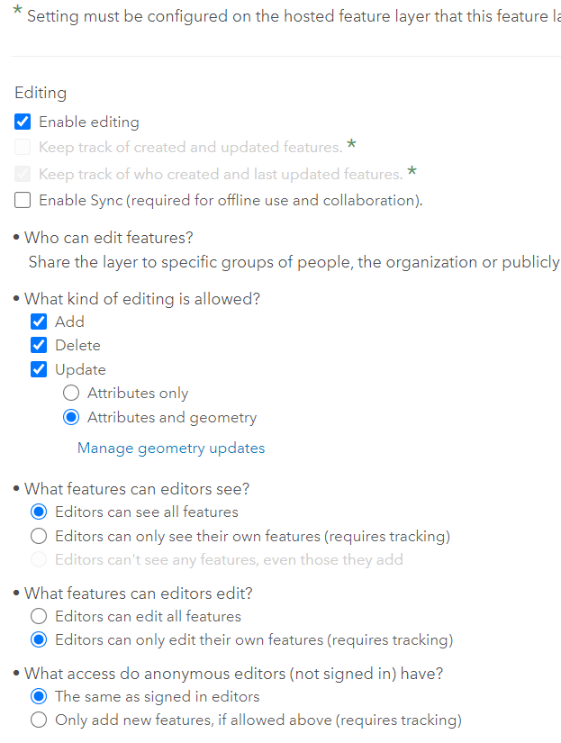

When creating hosted views, I am no longer shown the option to edit the popup attributes, or carry out editing in Map Viewer. This is despite Editing being enabled in the view layer Settings. For example, here the settings show editing is enabled:

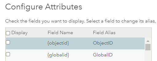

and the Edit options are also absent from the popup attributes menu.
