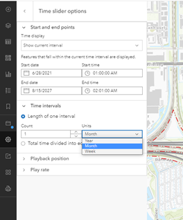

Hello,
In the new Map Viewer we can use the time slider but it is not possible to change the units to Week or Day. Only Year, Decade and Month are available. Typing the word in the pulldown list is also not working.

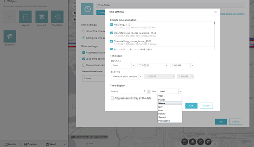

This is only possible when you make a webmap application (classic map viewer) and use the time slider widget it looks similar but there it can be changed to week or day.

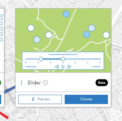

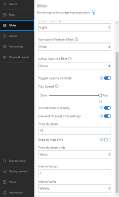

Additional to my previous message, I found out that it is possible but only when you create an Instant App with the time slider.
In the full setup settings it is possible to use ' Live and forecast time settings' to choose a smaller time interval.
- choose time duration an units (full time span of your data)
- now choose your interval length and Interval unit
