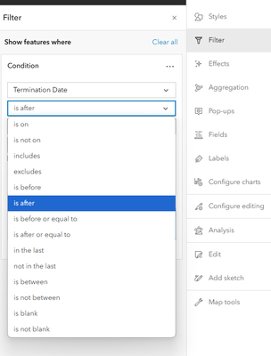

@RPGIS, not sure where to see those options in the map viewer filter builder. These are the date condition options I see:

Sorry @mwartman_grey ,
I realized that I was thinking of the filter that is used in the Dashboards. In terms of filtering by the current year, the best way is to usually create another field as text ( ex. "Current" ) if the year is equal to this year and filter by that value. There are python scripts that you can run to populate the field. You can go a step further by automating the script using .bat file and run using windows task scheduler.
