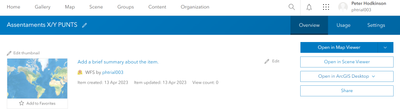

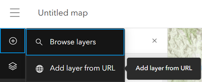

PeterHodkinson
Thank for that. I've been testing this in my own ArcGIS Online organisation and can see the same behaviour.
I've found an existing bug logged for this which is currently in review - BUG-000156736: WFS are not loading when adding the layers to the Map Viewer through Browse Layers. I'm hopeful that a resolution to this bug should address the issue for you.
In the meantime, the following options are working for me:
  1. Adding the WFS directly into Map Viewer using Add layer from URL
  2. Adding the WFS as a new content item then clicking Open in Map Viewer from the item details page
I hope this is helpful!
