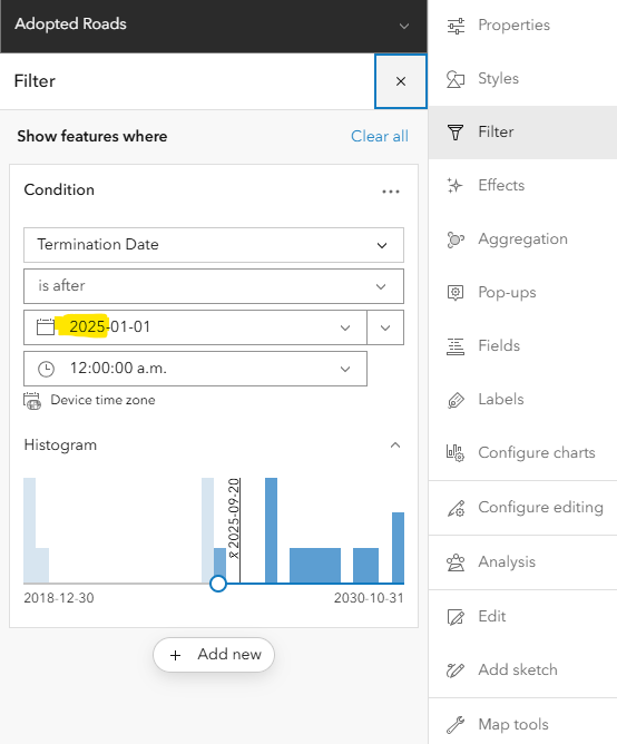

One option is to set the filter to be after January 1 of the current year, but this requires a manual intervention to update the date at the start of each year:

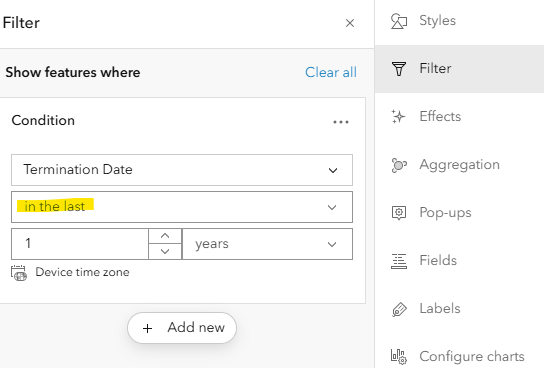

There is also 'in the last' filter, but this includes all dates in the past year, not by the calendar year.

mwartman_grey
@RPGIS, not sure where to see those options in the map viewer filter builder. These are the date condition options I see:
