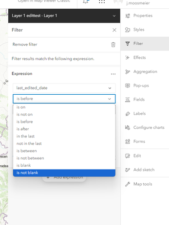

I have checked with my AGE 11.1 installation. For Filter it has the same options (see screenshot).
I don't have a 11.0 installation at hand, but at least the help for 11.0 says the same as for 11.1.
Something seems to be wrong

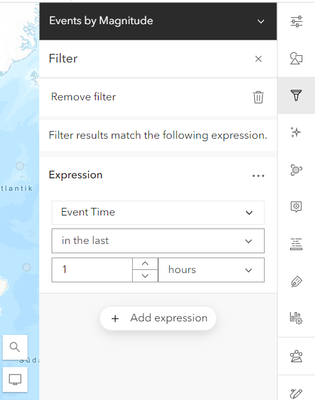

this is the filter for the layer:
The feature layer refreshes every 30 seconds.
And while I'm looking at the map, features come and go, dependent on Event Time. There seems to be a little lag time in updating the table.
So for me relative time filter into the past are working. There is no filter for '1 hour in the future' (for planed events in the future), I think this has to be done with a little Arcade Scripting.
