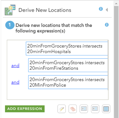

My recommendation would be to do the following:
  1. Create a drive time area for each input layer
  2. Instead of using overlay tools, you can use the Derive New Locations tool to find the locations where all the polygons you created in step 1 intersect, all in just one tool run.
    So you would run something like:

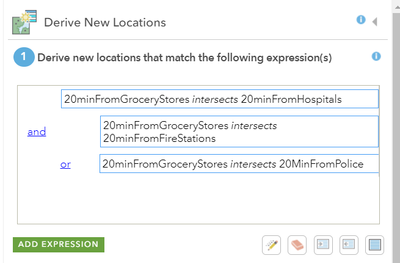

    There's more customization available too - say for example, you wanted locations that were 20 mins from grocery stores and hospitals, and 20 mins from either a fire station or a police station, you could format the expressions in the tool to be something like this:
