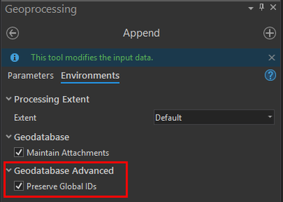

Will appending directly from the Hosted FS preserve GlobalIDs? I wasn't even aware that the append tool could accept a feature service as input. Learned something!
JakeSkinner
Esri Esteemed Contributor
Yes, there is an Environments setting to do this:
