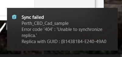

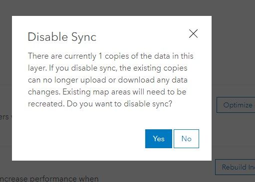

WRT disabling the sync — this is a good idea, but the trouble is if the FHS has been taken offline in FieldMaps/Collector, it won't sync again even if you've re-enabled sync on the FHS.  There is a warning:  Unable to synchronise replica (because it's been removed!).
I've been investigating a method to update a very large, sync-enabled, FHS.  While it is possible to do so using the ArcGIS Python API (delete rows & append), I'm always going to have the problem of every growing replicas.

disable sync warning messagedisable sync warning message
Sync failed message in Windows CollectorSync failed message in Windows Collector
