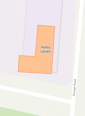

Could be something like
var name_array = Split($feature.name, ' ')
var first_name = name_array[0]
var last_name = name_array[1]
first_name + TextFormatting.NewLine + last_name
Before
After

Thank you @RussRoberts  for your quick help. I am trying to create split two-line labels for polygons in ArcGIS Pro (For like park labels for example), so they are the default in Online. The reasoning behind this as I cannot seem to find a way to do arcade expression labeling once the items are published so they are the default labeling when viewed in the map viewer.
Still working on the arcade, but it was hopefully going to work somewhat like this:
Which I got from:
Solved: Arcade Split Function: Split a name into first and... - Esri Community
Before
After
