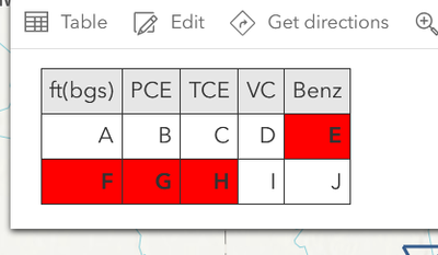

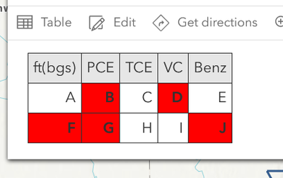

jcarlson
MVP Alum
Try to use an Arcade popop element. Instead of defining a ton of variables separately, you could write them all in a single expression and build the HTML that way. An Arcade popup element is capable of dynamic HTML, where a text element is not.
Also, certain styles will be inherited by all child elements, so you can set things like header background and font alignment on the table as a whole. Saves a lot of text and makes your HTML more readable.
Since you just need the "exceeds" field to control the background color, we can insert that into each row where appropriate. Using a backtick string, we can use template literals, inserting the values into the exact spot we need them.
// conditional style text per field
var t1d1 = Iif(
  $feature.test1ExceedsD1 == 'Y',
  'background-color:red; font-weight:bold;',
  'background-color:white;'
var t2d1 = Iif(…) // and so on
var html = `<table style="border:1px solid hsl(0, 0%, 30%); border-collapse:collapse; text-align:right;" cellpadding=3>
  <tbody>
    <tr style="background-color:hsl(0, 0%, 90%);">
      <td>ft(bgs)</td>
      <td>PCE</td>
      <td>TCE</td>
      <td>VC</td>
      <td>Benz</td>
    </tr>
    <tr>
      <td>{Depth1}</td>
      <td style="${t1d1}">{$feature.test1ResultD1}</td>
      <td style="${t2d1}">{$feature.test2ResultD1}</td>
      <td style="${t3d1}">{$feature.test3ResultD1}</td>
      <td style="${t4d1}">{$feature.test4ResultD1}</td>
    </tr>
    <tr>
      <td>{Depth2}</td>
      <td style="${t1d2}">{$feature.test1ResultD2}</td>
      <td style="${t2d2}">{$feature.test2ResultD2}</td>
      <td style="${t3d2}">{$feature.test3ResultD2}</td>
      <td style="${t4d2}">{$feature.test4ResultD2}</td>
    </tr>
  </tbody>
</table>`
return {
  type: 'text',
  text: html
I'm just using random numbers to assign the background color, but whenever the random number is greater than 0.5, it goes red.
- Josh Carlson
