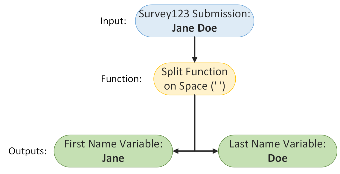

Hello! I am hoping I post this question in the right place. I am wanting to write an arcade script that would split one field collected in Survey123 into a first and last name.
I have attached a flow chart of how I anticipate this to work, my question is how to create variables for each word of the split (before and after the space).
Any help or other solutions are appreciated!

Split outputs an array, with each item in its own index in the array. So for your example, Split('Jane Doe', ' ') will output
['Jane', 'Doe']
Individual elements can be accessed by their index:
var name_array = Split('full_name_field')
var first_name = name_array[0]
var last_name = name_array[1]
Do be aware, this assumes a consistent entry of first name, last name as single words. My wife's maiden name, though, would throw this: "van Loon".

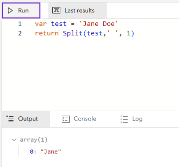

However, for future knowledge, it looks like the limit parameter might be able to stop a last name from splitting. In case you wanted to keep a last name with a space together, could the code look like this and still split on the first instance of a space?
var name_array = Split('full_name_field', ' ', 1)
jcarlson
MVP Alum
True, but suppose someone had a space in their first name? But yes, the limit parameter can be used that way.
- Josh Carlson
Kendall County GIS
KenBuja
MVP Esteemed Contributor
The number limiter means it will only return that many split items, so that would return just the first name in the array.
