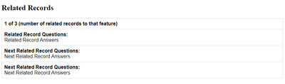

@NorthSouthGIS  How would I bring all the related records with a table that looks like below. Using the 1st row of each record that is related to features using the 1 of # of records to each feature (repeating records) ?  I hope I am clear with my question.
Marshal
I don't fully understand your question, but you might want to take a look at the code I shared.  It iterates over potentially multiple related record "groups" and builds tables for each of the "groups", which is what your screenshot appears to represent.
