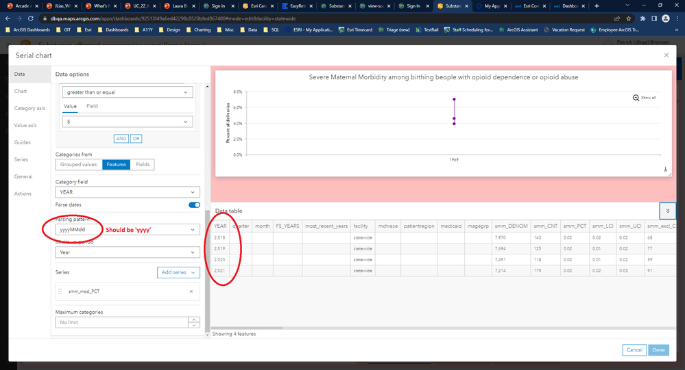

@KateHand For the June release, we had to change the code library that parses strings (and numbers) into dates. There are situations where the previous library was much more 'forgiving', and a chart that has always worked might start showing No Data, or weird results like what is below.  With the new library, the serial chart's config settings must match the data and you might be able to get things working again by simply changing the parsing pattern.
Note: When changing the above to 'yyyy' on my testing dashboard, I noted that the chart did not update correctly and appeared to be empty/blank. This is another small issue for us (i.e. preview not updating correctly). Simply clicking done (to finish the configuration) worked around the problem.
