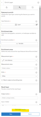

@MichaelVolz - i think nearly all the tools that consume credits have this 'estimate credits' button at the bottom of the tool dialogue, at one time i think you couldn't even run a tool without checking that, though I'm not sure that is true any more. This also shows up in ArcGIS Pro when you use tools that consume service credits, it shows up a little differently but its pretty obvious.
clt_cabq
did you check the number of credits your enrichment was possibly going to cost? if it was greater than the 2400 you have remaining, that is the issue.

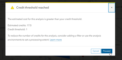

AmandaRing
If you have credit budgeting enabled in your org, then all webmaps in Map Viewer will come with a default credit threshold of 100, to prevent folks from running analysis that ends up costing them way more credits than intended.
It is just a warning though, and you should still be able to run your analysis by clicking on the Proceed button. Note that as I read it, I agree that it's not super obvious that that is the case.
You can turn off this check or set the threshold to a much higher value in your webmap if you'd like by going to Analysis > Analysis Settings (at the bottom of the home tab) > Crediting
Please let me know if you still have issues running your analysis @SuzanneLeckert !
