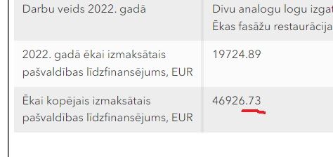

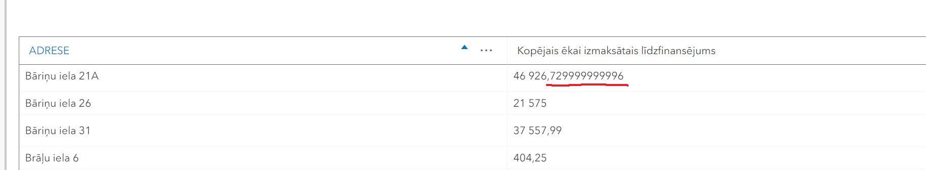

Hello!
I have created ExperienceBuilder app with table widget displaying field of numbers with decimal places. In the webmap I have configured decimal places up to two digits, but in the ExperienceBuilkder Table it displays many decimal places. It appears not to all othe entries but to several of them. As these are money amounts, the more than two decimal places look weird. Where should it be configured to display certain amount of decimal places? Below are examples (screenshots) showing decimal places of the same entry.
Screenshot No. 1: Experience Builder Table widget number decimal places extended
Screenshot No. 2: WebMap pop-up of the same element number field

How is this fix coming along? I have Manholes with slopes in EB looking like this: 1.02365897458295%

Has this been issue been resolved? I am currently having the same issue as those in the chain above with multiple decimal places in the table hosted feature layer I am using in my experience app. I have not as yet found a solution to this in AGOL or Experience Builder? Any updates from ESRI would be much appreciated.
AndrewWelsh
Update on my last message - I found if you are publishing an excel file to AGOL as a hosted feature layer for use as a table in experience builder, you can set the data type to double as you are preparing the layer for publishing. I had it on single data type initially and got heaps of decimal places turn up when I used in experience builder. But setting the type as double, the table displays exactly as I have set it up in the excel file (in this case 1 dp). Hope this helps!

I am also dealing with the same issue. Unfortunately, I'm displaying data from a Chart Statistics Output View (generated in a Chart Widget in the same app) in the Table Widget, so I have no option to edit the decimal places in the source data outside of Experience Builder. It displays acreage as 5.37392027759302773674 acres which is absurd and does not look professional at all.
