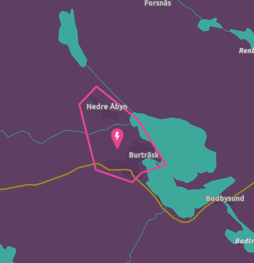

Here is an example of a custom Web Style I have created that symbolizes a polygon as both a polygon and a point. The same should be possible for lines.
