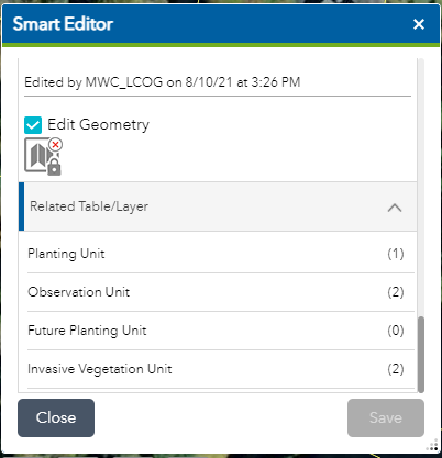

I've configured a map that has a relational feature service in it. I built a Web App builder application on the map. I have configured the settings to allow for editing. The Create new feature icon is missing from the related features entries at the bottom of the Smart Editor Widget control panel:

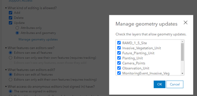

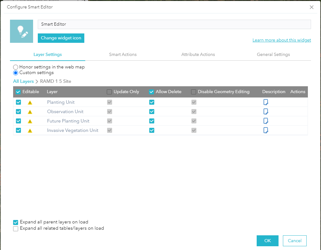

I note that in the Configure Smart Editor dialogue, in the Custom settings for the parent layer, that Update only is enforced for the child layers. I have looked through Untitled picture3.pngthe layer and the map settings, and do not understand what is enforcing this. In the layer settings, for instance, geometry updates are enabled for all layers in the service.
Any thought on how to release the lock on Updates Only?

Hi @DavidRichey ,
Only related Table layers are supported for adding new features. If your layers have geometries, then you will not be able to add new features through the related table/layer list. This is a limitation for this widget and it's explained into more details here: Smart Editor widget—ArcGIS Web AppBuilder | Documentation
I hope this helps!
AlixVezina
Presently, there is no easy way to do this on the web. Editing related records and features should be on the roadmap for future editing tools built in the JavaScript API 4.x , so you should see this eventually in the new Map Viewer and in Experience Builder.
Perhaps, another way you could get around this limitation, would be to have a "project area" polygon layer. The polygon layer would have a field for the key ID you are using to relate your features.
You could then use an Intersection Attribute Action in the Smart Editor to get the ID from the polygon for all the features that you place within the area. In this way, the ID will be automatically populated into your related features, which will prevent user error and be less tedious.
If your "project areas" overlap, you could use the Value Picker to pick the key ID (in other words, the relationship) you would want the feature to participate in.
If this doesn't make sense, I can put together a quick example.
