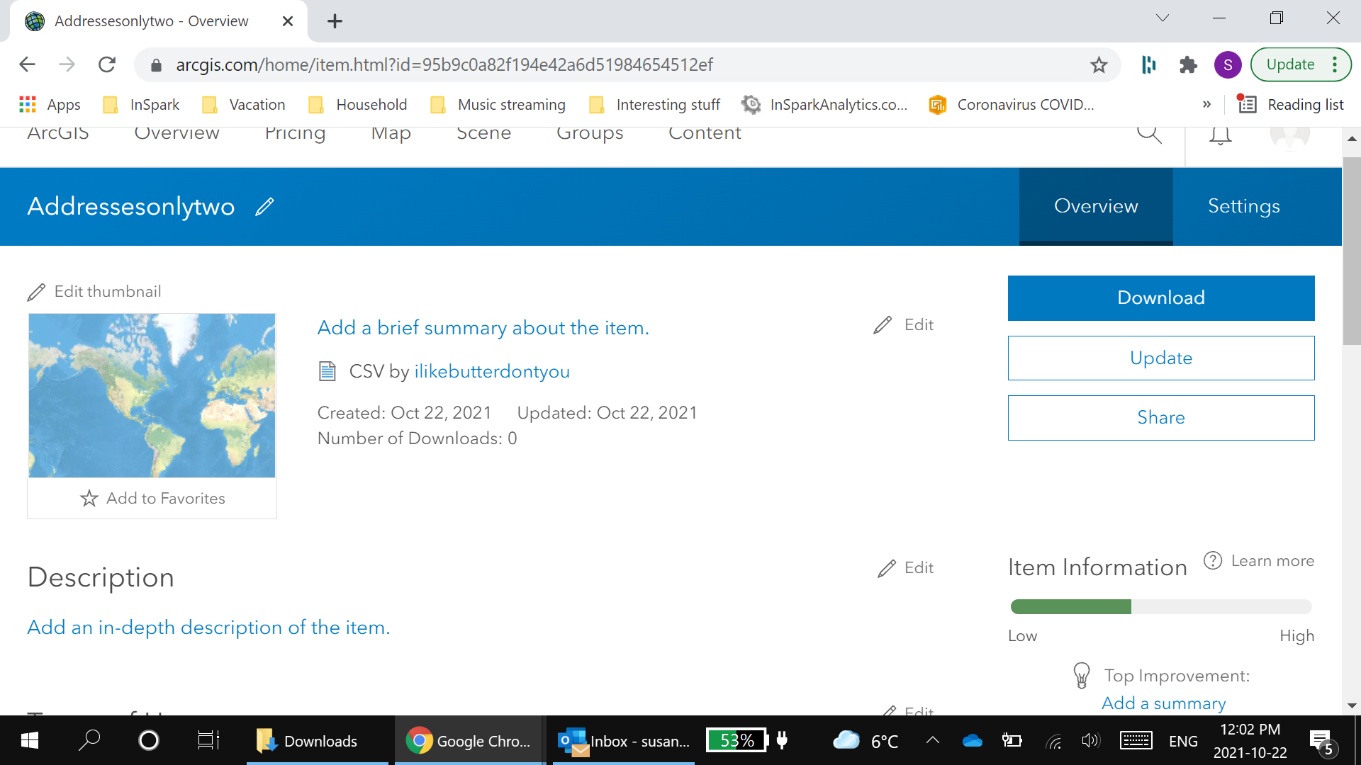

I then used the same steps to load my excel spreadsheet with addresses, residents, and occupations. I created a map, but, only one address was found. I then decided that I should add the postal codes for the addresses and added that to my excel spreadsheet.
When I sent back to load that updated spreadsheet the program then told me that excel wasn't supported. I used content/new item, and dragged the file into the box.
So, I created a .csv file and dragged that into the box. However, unlike the tutorial I did not get "Choose Add Microsoft Excel document and create a hosted feature layer.", the step 4 in the tutorial. Instead I get
I fiddled around with things like no space in the file name, just, (as above) address, no occupants and occupations, etc.
And, here's the weird part - the tutorial is no longer working as it did. I get the same error message that excel isn't accepted and the same page, as above, when I .csv

Your 21 days student trial might have expired. And then it gets converted to public account. You can't do this activity using a public account.
If you are interested to learn ArcGIS platform and explore more features, you could purchase ArcGIS for Student Use or ArcGIS for Personal Use. These are annual subscriptions with ArcGIS Online and ArcGIS Pro licenses for non-commercial purpose.
Meanwhile, I have just published your data as a hosted feature layer. Feel free to use it.

Are you sure you have logged in with an ArcGIS Online organization account (Trial Account)?
Looks like a public account to me.
Geocoding (converting addresses to points) consumes credits, which is not available with public accounts. Has it been 21 days or more, since you registered for the trial license?
Meanwhile could you share the CSV or its sample for us to check?

Thanks for getting back to me Jayanta. I did not set up an organizational account as I'm not affiliated with anyone, it's just a history hobby project. So, I got the free trial for a student account. Or, at least, that's what I think I did. The free credits thing did come up when I did the tutorial, it warned that I was going to use one or two but in my memory I got 200 free with the trial. What's really strange is that the tutorial wouldn't work the second time. That makes me thing there is something glitchy with it. I've attached the tutorial files (Ancient cities) and my files in .csv and excel.
