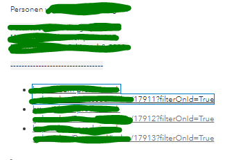

Based on the a related (1:M) table, Enterprise 10.9.1.  I need to define the link to navigate to the source application.
So I do get X (based on available names) separate bullets with links. If I copy/paste the link it is working. But If I click it, to start it within the PopUp, it will open the current WebMap again.
Current result:
I do have a feeling that I still need the concatenate somehow, but I do not get it fit in. If I use it at the end, it will cluster the multiple links again.
