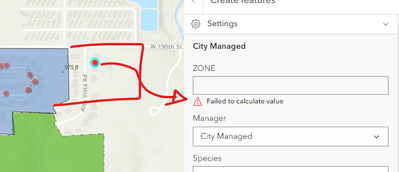

@JohannesLindner I am using your code in a similar fashion, , it's working great if I click inside my Zone (blue area) but if I click outside I get the following warning message. Technically, since I don't have a Zone to intersect I should be getting a "NULL" value correct?
What am I missing?
Thanks!

DominicRobergeIADOT
Sorry, I solved my problem:
// Get other layer from datastore
var other_layer = FeatureSetByName($map, "Tree Inventory Areas")
// Intersect layer and feature, use `First` to take the top feature
var intersectFeat = Intersects($feature, other_layer)
//check for intersects
var intersect_count = Count(Intersects(other_layer, $feature))
var noZone = "999"
if(intersect_count ==0) {
    return noZone
var xs_feat = First(intersectFeat)
var Zone =xs_feat["zone"]
//else
return Zone
