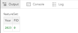

I'm trying to create a FeatureSet from an Array.  I've setup a for loop to cycle through the array and add a new row for each record in the array.  The issue that I'm running into is I cannot figure out how to add a new row.  So I am always overwriting the previous record.
My array is  YearList = [2018,2019,2020,2021,2022,2023] and I would like a table like:
YearFID
20180
20191
20202
20213
20224
20235
var YearList = [2018,2019,2020,2021,2022,2023]
for (var Yr in YearList){
  var yearDict = {fields: [{alias: "Year",name: "Year",type: "esriFieldTypeInteger",}],spatialReference: '',geometryType: "",features: [{geometry: "",attributes: {Year: YearList[Yr]},}]};
return FeatureSet(Text(yearDict));
