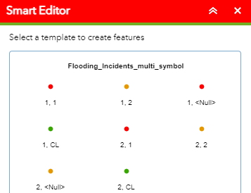

Using ArcGIS Pro I symbolised every variation I can think of and the Smart Editor Widget looks like below.
However I only want to include 1, Null and 2, Null as the web mapping application is used at the point of adding the initial record and allocating the Reported Risk Priority.
Other than having lots of separate layers I cannot think of another way to do this.  I hope I have managed to explain my problem?

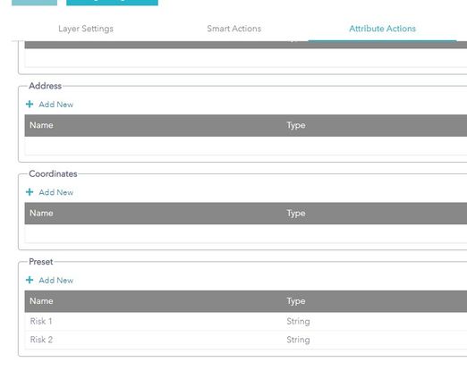

5. In the Smart Editor widget configuration, Attribute Actions tab, go to Preset section.
6. Add a new preset group, and set the preset value of "1, Null" against the field in your "1, Null" feature layer view. You can optionally hide these presets from the editor by checking the related checkbox. Repeat for "2, Null" with a new preset group. You should now have two Presets, one against each of your feature layer views.
7. Save the configuration.
Now, if you create a feature from the "1, Null" layer, the value "1, Null" will be written automatically into the field. Quick similar example below - Risk 1 and Risk 2 layers  are hosted feature layer views created from the Hosted_Layer_Example layer. The Preset values Risk 1 and Risk 2 are assigned to the features in layer views Risk 1 and Risk 2 respectively.

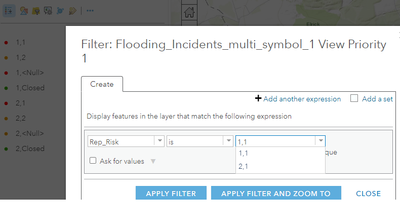

Thankyou for the detailed response, I think this solution may work and I have been trying it out.  Unfortunately I have ran into an issue at step 2
 Configure a filter against each of these hosted layer views in the visualization tab to only display the features for "1, Null" or "2, Null".
In the filter expression Null values are not listed and cannot seem to type manually without getting a yellow error warning.  There are definitely entries with Null values in the second field (Response Risk).
Would you be able to clarify the Filter expression please?

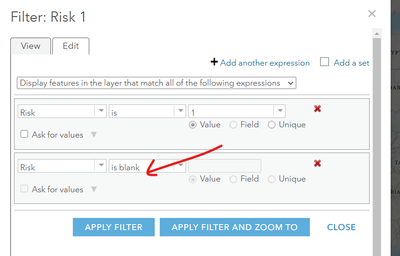

@CMcDonald I think you may need to add more than one expression? There's a dropdown option for "is blank"
And from the dropdown at the top, "all" stands for AND and "any" stands for OR... if I'm not mistaken.
