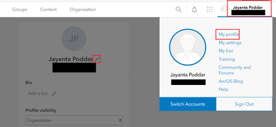

What could work is you could interchange the first and last name in your Profile Setting in ArcGIS Online.
