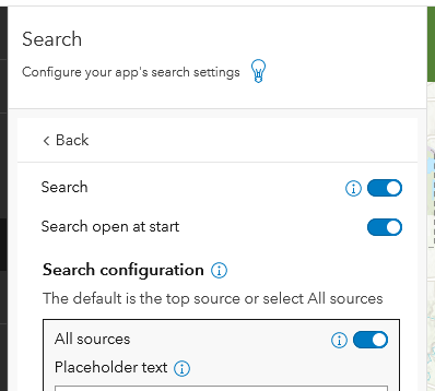

Not sure about dashboards, but if you create an app from the map you can easily do that. Here is the setting in Instant Apps, which are the easiest to set up, though with limited options compared to Experience Builder, etc.
