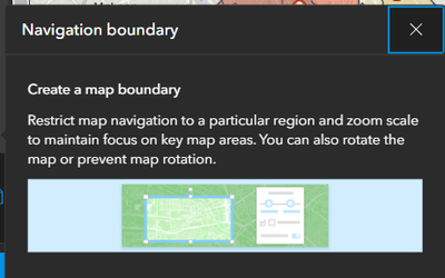

One way to do this would be to use an Instant apps template that supports a Navigation Boundary. The boundary restricts folks from panning the map outside of an area you set. This would ensure that all of the points they create would fall within that area.
