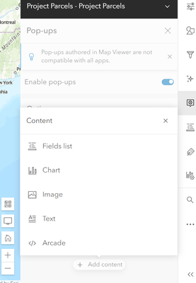

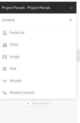

Hi Ken. I just published the same feature service to both AGO and ArcGIS Portal (11.1). In AGO, I can use the 'related Records' item to show my related tables' pop-ups in their own window within the pop-up pane. Meaning, the user has to click on the pass-through link on the default pop-up to see the related table pop-up. In Portal, this option is not available when clicking 'Add Content' in the pop-up config panel (I'm using Map Viewer). Is it just a Portal limitation??
I understand you can circumvent this issue by editing the Arcade code, but the issue with that is a UI nightmare for user groups that are extremely nit-picky (like mine). I have a lot of data in each related table and it makes the pop-up enormous, forcing users to scroll forever to find the data point they need.
Juan_Toro-Killion

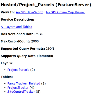

I should mention my feature service is Portal is indeed hosted, and not a server service.
Images for proof: First one is Portal 11.1's Map Viewer
AGO:
(In Portal) feature service REST endpoint:
