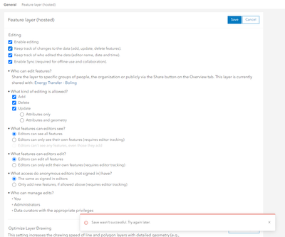

I'm getting an error message when trying to Enable Sync for my feature layers:
Save wasn't successful. Try again later.
I don't have any creator/editor fields in my data tables. Not sure what's preventing this.
I published two feature layers (part of a feature dataset) in a webmap through ArcGIS Pro.

I came across this same issue today. Initially it was just one of the sub-layers that wasn't allowing sync, however when I disabled sync for all layers and re-saved, it became an issue on all layers. The solution ended up being to just overwrite the whole feature layer from Pro and then enable sync. Not pretty, but necessary in this case.

I had this issue earlier today. I had a hosted view layer (that wasn't being used any longer) based on the feature service in question. I think something was wrong with the hosted view layer, because when I deleted the view layer, I was able to successfully save the sync setting on the main feature service. I got the idea for removing the hosted view layer from this bug article: BUG-000140593 for ArcGIS Online (esri.com)

Check out this post. Alexa Kennel's suggestion was my issue when I created a new layer in AGOL and couldn't enable "enable sync". I had a "date only" field type. Changing it to just a "date" type fixed my issue.

I ran into this same issue today.  After analyzing the dataset in preparation for sharing online, I came across error 00411
My dataset had a 64-bit object ID field, as well as a couple of Bit Integer fields.  Both of these prevent enabling sync.  The solution was to recreate the feature class using the solution posed here...
How do I downgrade objectID from 64bit to 32bit?
