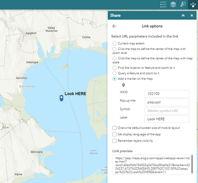

Closest thing OOTB would be the share widget in WAB and sharing the URL.
This is 1 marker/POI per 1 URL.

I'll run that past people, but I think it should work. I'll need to write some instructions about how to use it, as many of my users aren't very GIS savvy, but hopefully that will work.
