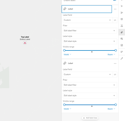

I would do 2 different label classes and set the position for the label with the label styling.
