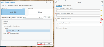

You can try reprojecting both the datasets to a third projection i.e. GCS WGS1984 (code: 4326).
Also add both the projected outputs to a new map to check whether this fixes the issue.
