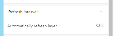

I see that I can set an refresh interval for layers in the new map viewer.
But I don't see the option for a refresh interval in properties for tables? Is this feature missing?

ZaraMatheson
Hi! Refresh interval is not available for tables yet, but it will be included in a future release.

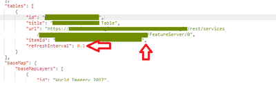

Arnon
I encountered the same problem and came across this thread. Indeed the option to set interval is missing for tables in the interface, but you can set it using the ArcGIS Online Assistant. It is explained in this thread for layers, but it works the same for tables.
DrewMoffitt
Using that thread to explain the AGO-Assistant, use the following format to add a refresh to a table for the new map viewer.
1) Locate the tables in the JSON.
2) Add a comma behind the "itemid" item as pointed out with the up vertical arrow below.
3) Enter a new line and add "refreshInterval":0.1 as shown below with the horizontal arrow below.
