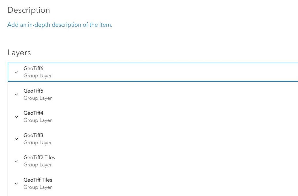

petermarkey
I have not, I would not know how.  Very new here.  I found an item details link that took my to the "summary page for the map.  Each layer of GeoTiffs should contain several tiff files, but non show up?  but they upload took so long they have to be there...????item details.JPG
petermarkey
The size of the map on the summary only shows 2KB but as mentioned it is 7 GB of Tiffs in the map, and it took that long to upload.

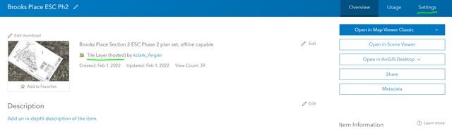

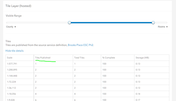

Katie_Clark
MVP Alum
Hmmmm, well maybe my process is a little different than yours. I publish tile layers by themselves, so there's an Item Details page for the tile layer.
If you click on the "Settings" tab, you can see the number of tiles that are built for each level.
When I add these layers to a web map, they show up as "Tile Layer", not "Group Layer" like you have in your screenshot, which is why I mentioned that our workflows seem to be different.

petermarkey
I see the group layers, but none of the items they contain (the GeoTiffs)
