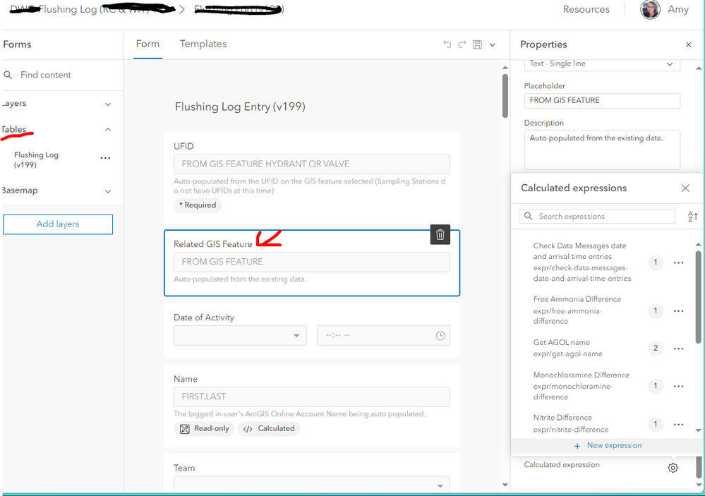

Will this work to populate a new record of related table? This fieldmap was created from three feature classes related to a single table, then published as a referenced feature layer to AGOL. The field map users only edit the table with a new record. Can the functionality that allows for autopopulating for data from a feature with the FeatureSetbyName be used in the conditional expression on a field in a FieldMap form?questions for ESRI community.PNG
