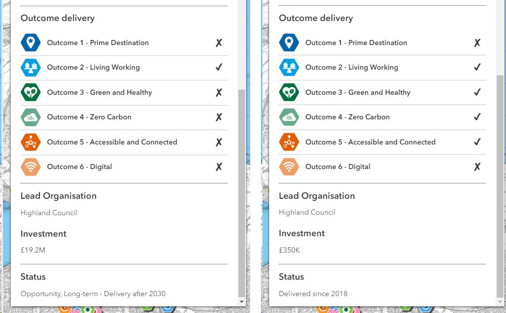

Thanks Ken, that worked perfectly!
return iif
  IsEmpty($feature.Expected_Delivery), $feature.Status,
  `${$feature.Status}, ${$feature.Expected_Delivery}`
  The attribute expression gives the two different outputs I was after at the bottom of the popups:
This is going to save me a lot of time writing definition queries and making custom popups for things!

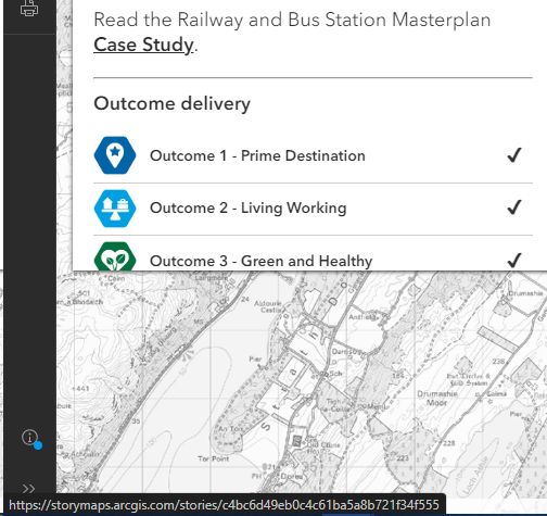

As a follow up, is it possible to include hyperlinks in this sort of thing?
There are a number of projects that have either case studies, websites or both associated with them.  At the moment, I have to make a layer filtered to show only those that have the case studies and/or website and write the following into the popups for them:
<p>
    Read the {Short_Title} <a href="{Case_Study}" target="_blank">Case Study</a>.
</p>
To make this sort of thing where "Railway and Bus Station Masterplan" is the {Short_Title} and URL for the hyperlink is the {Case_Study} field.
I altered the first expression to show nothing if the Case Study URL field is empty but to display the text part if there is a Case Study URL but I have no clue if it is possible to make the words "Case Study" into a clickable link with the field[Case_Study} as the destination.
return iif
  IsEmpty($feature.Case_Study), " ",
  `Read the ${$feature.Short_Title} Case Study`
Is this even possible within the attribute expressions?
Thanks again for any ideas - really appreciate it!

You'll have to use an Arcade element, which can return html code.
var output = iif
  `Read the ${$feature.Short_Title} <a href="${feature.Case_Study}">Case Study</a>`
return {
	type : 'text',
	text : output
