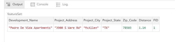

which results in:
Is there a way I could simply convert this to a text string so I could use it in a popup like below?
" The location is at Padre De Vida Apartments - 3900 S Ware Rd,  McAllen  TX 78503 - 1.14 miles"

When you've got your filtered FeatureSet, you can then use the function First to access the first record from the set. Then you can access its attributes directly. Try this at the end of your expression:
// picking up at the end of your expression
var filtered = Filter(topTwo, 'Distance > 0')
var f = First(filtered)
// build output string with a template literal
return `The location is at ${f['Development_Name']} - ${f['Project_Address']}, ${f['Project_City']} ${f['Project_State']} ${f['Zip_Code']} - ${f['Distance']} miles`

GregReinecke
Josh,
I was just digging into the First function and bam you were there to help!!!! It worked perfectly. Thank you so much.
