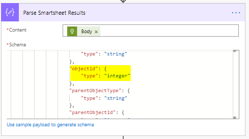

I expect it is because when Flow autogenerated the schema when you uploaded a sample json, it takes a guess at the type of data (many times erroneously). All you need to do in your schema is delete the type or change it to integer.
PaulSweeney3
Hi thanks for you response (I really should have posted an update here) i had eventually figured this out and this was exactly what i did i removed the types and it worked perfectly. This is a really useful tool for us now.

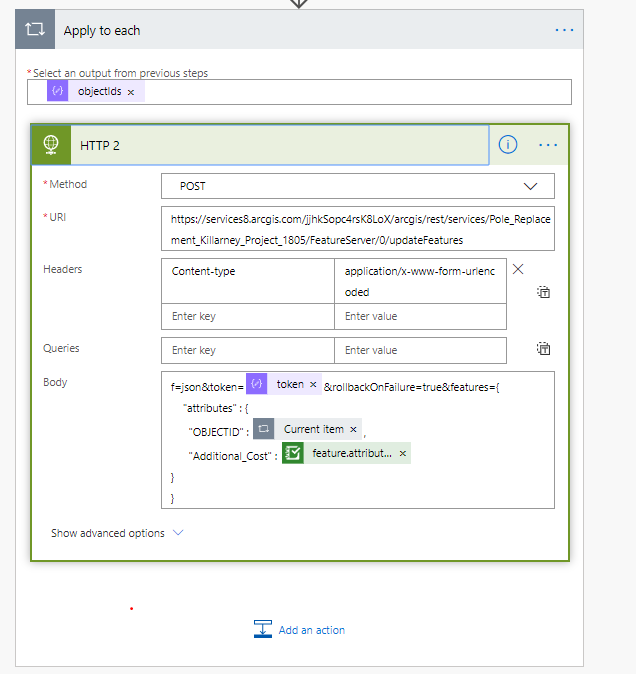

PaulSweeney3
Hi Chris
See below. you only need a header as per my screen shot then a post
then for each object id in th e query you need to apply the edit as per below

Thanks for the reply. With your help I was able to get my query to work but it looks like I'm running into the same issue as your original post described. When the last component (POST - Update Features) attempts to run. Any insights you may have on this would be appreciated.
{"error":{"code":400,"message":"Cannot perform operation. Invalid operation parameters.","details":["'features' parameter is invalid","Invalid JSON primitive: ."]}}
PaulSweeney3
Hi Chris
you need to look at the json in your Body , you have a comma after your colon Object ID:, you need to remove it.
