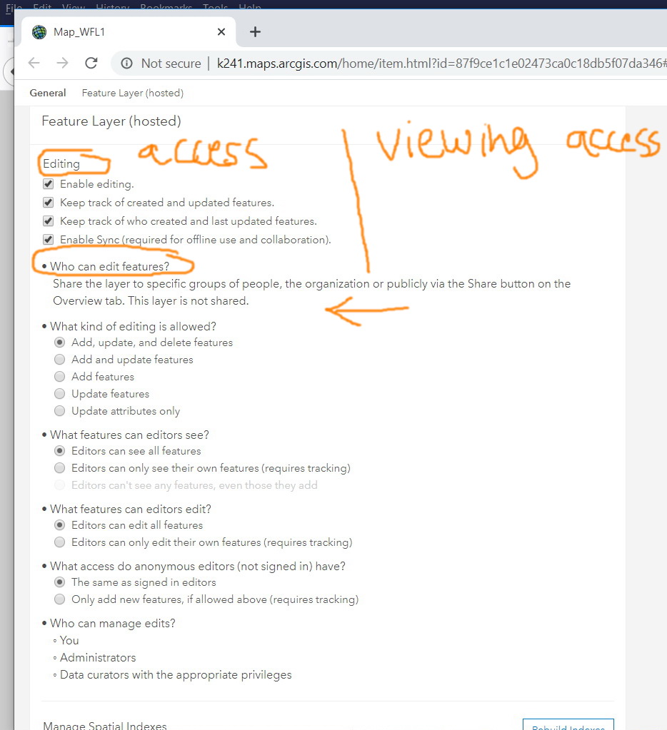

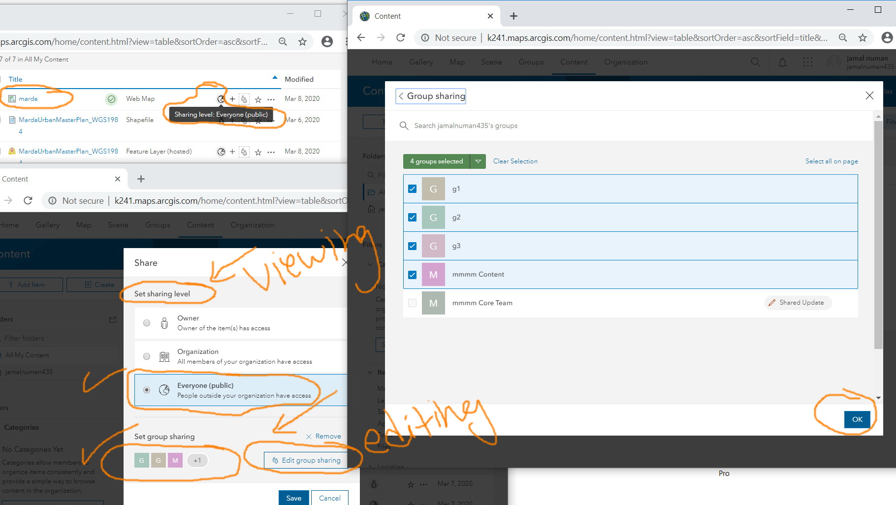

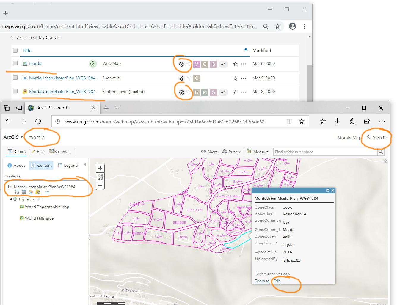

Despite the fact that the editing level permissions are set for users belong to particular groups, I observed that editing is still enabled without the need to sign in!
What could be the issue here?

If the map and the layers in it are shared publicly, then it can be edited by anyone.
The recommended workflow is to create a hosted feature layer view of the layer to be used in the public map that does not have editing enabled. For those people that need to make edits, create an additional web map that is only shared internally that contains the hosted feature layer that has editing enabled (but is not shared publicly).
See "Is the Item an Editable Hosted Feature Layer" in this Esri help page:
Best practices for sharing—ArcGIS Online Help | Documentation
There is a ton of documentation that Esri has provided for ArcGIS Online workflows and best practices, I highly recommend reading through it to see what other information you can glean from it.

I found out that the permission plan structure for ArcGIS Online is a bit confusing. I think that this issue can be resolved if the permissions for viewing and editing access options are made available.
For example, a layer can have the following permission plan:
Viewing Access:
Every one
All users (members)
Groups:
Editing Access:
Every one
All users (members)
Groups:
Jamal Numan
